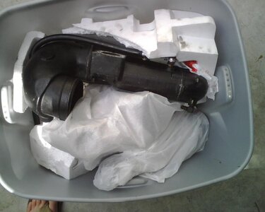

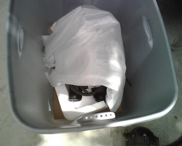

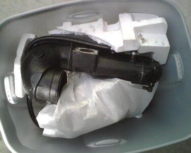

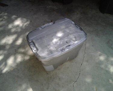

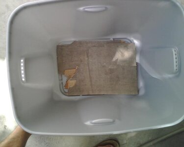

how i fit a 300sx engine in a 18gallon rubbermaid
2006superjet
just one more part....
costa mesa ca
this is dor anyone who need to crate on a budget.
total cost 499 for crate and 399 for duct tape freebie printer box and shingle
9$ total

I have sent quite a few engines and never had a problem with a layered cardboard box. Get a large cardboard box and layer it with bubble wrap then place cardboard inside then the engine. Works great and free if you have bubble wrap laying around.

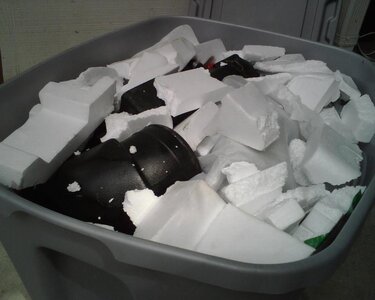

i have some left over foam from my build if you need it

ive been shipping motors like that for a few years...
old clothes or sheets or pillows work great as padding
smal screws through the lid into the tote work well to keep the lid on even if the UPS/DHL/FEDEX driver drops it from 6 feet

sent an engine to LBE using the same method except I double wrapped the shortblock in heavy duty carbage bags and then sprayed expanding foam all around and up under it to really lock it in place. everything went well exept I left the spark plugs in there and UPS decided to drop something on top of it. Not sure if I will go that route again!
