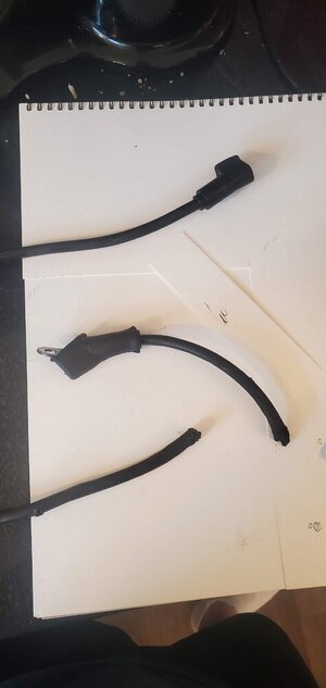

- NEVER add an additional ground between the ebox and the battery. What happened is the ground wire between the battery and the starter was broken and making intermittent contact. I couldn't see this because it was in a plastic loom with no signs of wear. It also passed every test with a multimeter. What happened was when I added the second ground, all of the power the starter uses back fed through the ebox and went through the wire I added. The smoke was this wire melting from end to end. Thankfully, it was a lighter gauge than what is from the ebox to the engine, otherwise, this would have been the melted wire.
