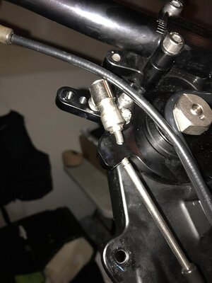

The push rod on my steering snapped. Do I need to replace the entire steering cable? If so, how the heck do I do this?
Is the best one the Blowsion Heavy duty? I have a 2016 SJ/
Also, anyone know the best place to have this done at in NC?

5. Have you put any aftermarket steering components on? Aftermarket handlepole? Usually cables break in this spot because something wasn’t aligned properly. It looks like your end has a bend in it, too. It’s kind of shocking this broke on a newer SJ.
NC
1. Winston Salem, I broke it and was stranded on lake norman today. SUCKED.
3. Do you have a link?
5. It has a blowsion turn plate and zero degree bars. The steering was mounted on the furthest setting out. I see now that it appears when turning left (what I was doing) that the steering rod bottoms out and therefore breaks. Im not sure the best way to fix this though because if I move it to the furthest hole it still wont reach and then it will throw off the steering to the right..

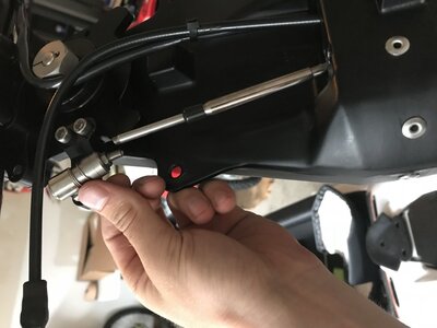

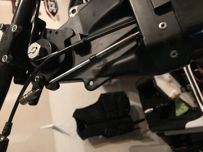

Attahced pictures where it's definitely bottoming out to the left...

You need to adjust the steering cable ends. Just loosen the jam nut and turn them in/out as needed.

Yep, unfortunately it broke because you didn’t have it adjusted properly after putting the aftermarket turn plate on. Next time, you need to make sure the turn plate hits the steering stop on both sides, and then have the cable adjusted within that range.

So the way i understand it, the steering cables 08+ are shorter throw, and with a/m steering, you bottom out the cable more often than hit the steering stop. Meaning, the cable supports X inches of movement, but with steering changes for faster response, you actually need X plus some. Thus, you either adjust steering to less throw, defeating the whole point of a/m steering, or get a longer throw cable (such as a pre ‘08 cable and adapter kit). @JetManiac sells both cables and adapters. I’m getting ready to do this exact thing on a 2017.

Exactly, the Blowsion cable will not fix your problem without modifying how your cable is mounted.
Starting in 2008 Yamaha changed the SuperJet handlepole to have a shorter pole. The top casting of the pole was changed in '08 to a shorter piece with a shorter throw steering cable for some reason no one seems to know why. The 08-up steering cable is shorter in throw to fit this new pole design. This is why the 2008-up do not turn as well as 1996-2007 SuperJets.
You can change the steering cable to the longer throw of the 96-07 SJ cable, but you have to modify cable mount area, and the cable attachment point needs to modded/opened up and moved inward down the pole. We sell a relocation bracket to fit the longer throw cable.
After replacement you can take advantage of a/m steering systems with more throw or move ball outward on stock turnplate and also move the attachment point inward on steering nozzle for more throw as well.

This is exactly right. The aftermarket steering are designed for the longer through cables. On my 08 SJ I modified the steering attachment to accept the pre 08 cable. I am using a blowsion OVP and hav no issues bending the cable.
However on my FX1 I am still using the stock steering cable which is the same as the 08+. I have a cold fusion steering set up and I have adjusted it as much as it will allow but I am bending the end like you did. My plan is just to do the steering mod like I did on the 08 and use the pre 08 cable. This is by far the way to go as it really makes the ski steer awesome and no more bent cables.
