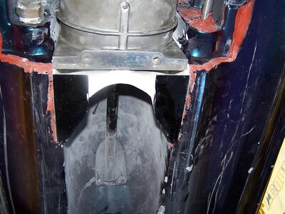

the bigest part off the job is fitting the new pump shoe into the hull . it is slightly longer than the 650 shoe area and you have to reshape the new one to fit into the 650 hull and trim it to match your scoop grate . the 750 pump just bolts in like the 650 so i masked up the fromt off the pump and bolted it in . then i used epoxy resin mixed with filler power so it was nice and thick and glued in the shoe and filled round the front off the pump onto the masking tape inside the top off the tunnel and shoe so i have a nice area for the pump to go up against . once the resin had gone off and was sandable i removed the pump and sanded the inside off the top off the tunnel to match the pump and smooth the shoe area and that so the water flows over it nice .

pic 2 : shapeing and test fitting the new 800 pump shoe into the hull
pic 3 : rear view off shoe been mocked up
pic 4 : rear view off shoe ready for glueing
pic 5 : shoe all shaped up ready for glue
