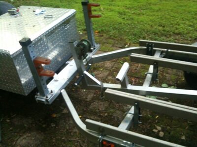

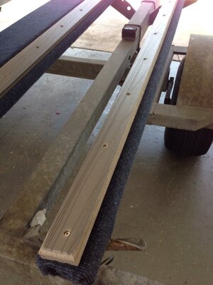

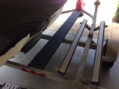

Use composite 2x4 or put composite deck boards on top of 2x4. Ryan recently did his trailer with 2x4, and then cut a single 20' deck board in half twice, once long, once short. Worked well.

I haven't bought 2x4. The 2x4 are wood, covered in carpet, with deck board on top. I think there are some marine dealers that carry 2x4 but not for sure.
