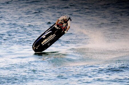

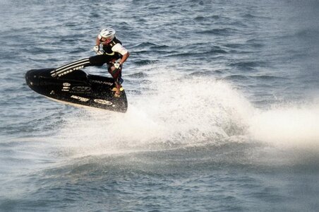

Hi this is my first post i attached pics hope it will help you:
turn your plat 1/4 to the left then full to the right (pin your throttel), you just push your body with the rotation as in the pic:
then you will get your 180
