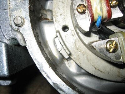

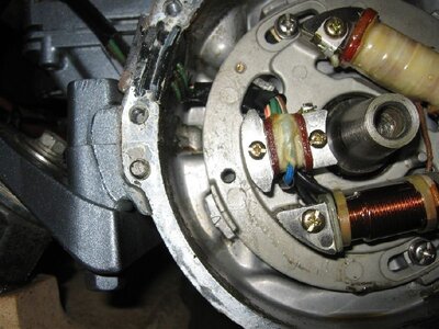

I only have one mark on the case. There's one mark on the stator and two little bumps on the stator that you can see in the pics. Do I rotate the stator clockwise or counter clockwise to advance timing? I don't want to screw this up and deto the motor. I do have some WOT runs up the lake sometimes too.

See how the top mark on the stator is further away from the center than the other? That's your 5 degree advance mark.
Line up the mark on the case right between that 5 degree mark and the center mark, and you should be good.
Counter clockwise advances timing. I personally would pass on running any additional advance on pump gas. Especially if you run WOT often.
Charles
I agree, why take the chance? Your already getting an advantage on the curve with the MSD

So the way it's setup now it's retarded a couple degrees??? That's the way it was when I got the ski. This is a 6m6 motor, and I also have a milled head with around 180psi. I thought I read somewhere that higher comp and advanced timing wasn't too bad on these because of the port timing.
