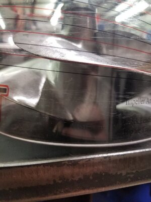

Sent my impeller off to impros, skat 7/14, measured out in my torrent gauge to 10/14. I asked for it to be repitched to a 6/12, got it back and now it measured out to be 9/12, impros told me it is a 6/12, so maybe I'm missing something? ..
Leading edge lined up with 9
Trying to line up leading edge with 6

Looks like 9* to me. I had a similar issue with impros before. Paid a lot of money for a plcustom prop and it was way off. They told me to get effed.

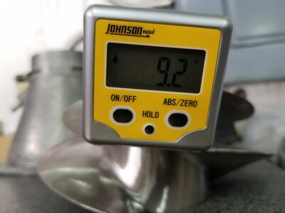

Threw my digital gauge on there and it says 9.2 degrees
Leading edge seems very subjective on the actual degree depending on who is reading it. I don’t know the technical term for the curved shape that our leading edge uses, but I think that’s where the confusion plays in. That’s why the trailing is so black and white and easy to read.
I think the actual curved portion of the leading edge, the first couple inches, is what matters most for how it will “bite”.
I’d say run it as is now, and if it needs more, start slightly tweaking the leading edge yourself with a crescent wrench little by little until it grabs how you want.

That does suck- plus with it starting out as a 10, and trying to bend down to a 6 is a big jump and will mess with your wear ring clearance and cause more gap, so be sure to measure it, you might be within range.
And when you bend it yourself, focus more on the curved portion and not so much on where you are measuring. Basically form an imaginary 90 degree line off the curved portion to paint a better picture of what the true leading edge is. It’s hard to see from the pics but where you measure seems to be where you’d almost expect the blade to start slowly forming into a higher degree as it tapers to the trailing edge.
But like stated, don’t focus too hard on the number, just start tweaking little by little.

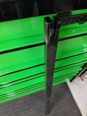

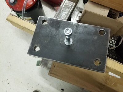

What tools did you use to bend it?
A 3/4" plate with a 5/8" stud welded in the middle, then bolted that to my 1000lbs steel bench to hold the prop in place.
Then I took a 3 foot long piece of 1-1/4 bar stock, cut a notch in the front of it, hard faced, then hardened it.
Made easy work of it.
All my prop bending experiences has been straightening seadoo props, I had a special tool to hold the props in the vice and my 12" snapon crescent always did the job, but it wouldnt touch this thin blade skat, much harder material and likes to flex a lot and not bend, so that's why I had to make thses new overkill tools.
