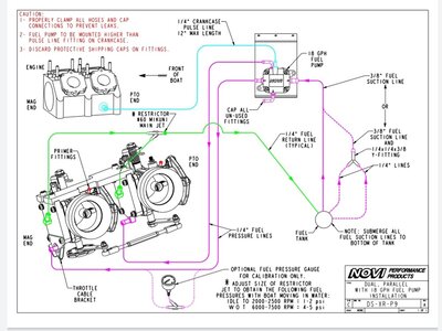

You might want to get a fuel pressure gauge and check it. Could definitely cause issues you're having. According to novi, 1-2psi at idle is ideal. 4-5psi at wot. I have a ported 735 with dual 44s. 70 jet was recommended, actually got a gauge and checked pressure. Was at 3.5psi at idle. Put a 80 jet in there and it immediately ran smoother. 80 jet put me at 2.5psi at idle. Still high but much better. Going to try a 85 next. Youd be surprised how much difference it will make. Theres a really good thread on here worth reading. I'll find it and post for you
Yeah I gave it a read already, like I said i didn’t bother checking because the front carb wasn’t having the issue at all out of the same fuel pump. Ed from full spec was extremely adamant that anyone running anything other than a 60 return jet (on his carbs) was making a mistake when I spoke with him on the phone Because I had also been playing with my return jetting. I will tear it down tonight and if it’s not a obvious issue I’ll start at the fuel pressure
My engine builder recommended a 70 jet. He did all of the modifications to the carbs I'm running and I've had a super tough time getting rid of a 1/4 throttle dead spot. Also had rear carb dripping like yours. I've tried different popoff pressures, seats, springs, and jetting. I was able to move the dead spot Lower or higher in the throttle position but never eliminated it. Plus terrible fuel economy. Finally got a gauge and measured it. Tried the 80 jet and it cleared right up. Thing you have to consider is your tuner can give you starting points but every ski is different. What might work on one ski might not work on another. Definitely worth checking especially if nothing else is working.

It was recommended to test while moving however I checked mine under load on the trailer. I will extend the hose to the gauge through the pole to see if it makes any difference in pressure moving vs on the trailer.
