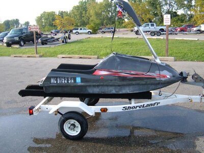

Just for referance, here's a hull I built over 10yrs ago. Full carbon 250Lbs. Sunk twice. punctured and repaired twice. Still kicking.
