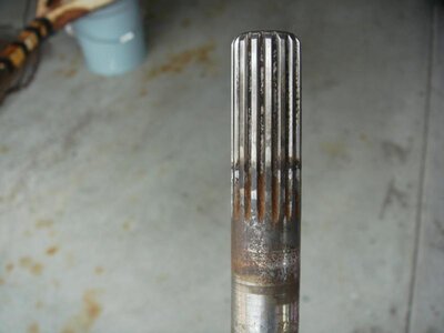

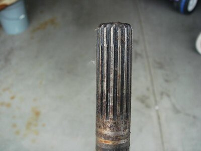

Check out both of these drive shafts that appear to be passable, they are BOTH BAD

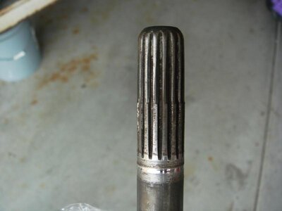

This one is GOOD, see the difference?
REMEMBER, if the drive shafts trashed SO is the midshaft

Crap thanks for the pics. My driveshaft looks like the first pic.
Some very good advice in this post, but another important point is spline engagement/overlap. When you first install your midshaft with new grease, pull it back off and check the grease trail for spline overlap. The first picture shows a spline underlap by about 1/2". You can also see that only 1 oring is riding on the driveshaft.
