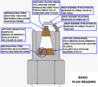

This always seems to end up with a low speed jet that is rich of "ideal" I've got four stroking and and the plugs always come out looking way rich, because most of the time the ski is not wide open so it is in the rich low speed part of the carb jetting. Going leaner (on the low speed) gets a hesitation.
Doing a plug chop is completely out of the question because I can't hold this thing wide open for any length of time.
So, is plug reading completely useless on a freestyle ski?
For those who have actually tuned a ski that has a motor/hull combination that can't be held wide open, do you do something different?
