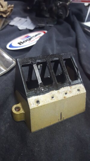

Had the same problems, and found two problems with my ski. One was a dirty filter in the carb (filled with white fibers) and under my reed peddles was messed up
