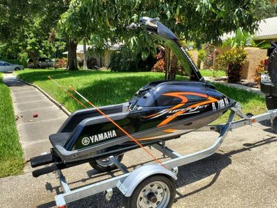

Is this superjet a good deal?
Found this superjet with trailer around 5k 40ish hours
I see used 2016s going around 6k im new to the scene wanted some input

Looks like a super clean ski, is it just the reflection but why is the orange part of the decal on the bottom of the ski faded?
Could be a 2013 too, the graphics are the same for both years.
could be faded it was salt water ran but kept up i plan on doing the 2014 decals anyway

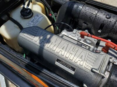

Any other evidence of saltwater corrosion, look in and around the pump.
Test the compression in both cylinders if possible.
Stress cracks around the handlepole bracket and the bottom of the hull or anywhere else it could have been abused in the surf.
Iv'e sold a couple 13-15's at $5K they basically sold before I logged off listing them. If they are clean and minty $4.5-$5K is a normal price
Buddy listed same ski at $5.5K sat for weeks and weeks until he lowered to $5K then it sold.

For the compression test. Should be around 150 psi with less than a 5 psi difference between each cylinder.
Most important is to take it for a test ride. A ski can sound great on shore, and run like crap under load in the water.
You should try to test ride it if possible. does it have an hour meter on it? I would be a little concerned if it was left for any extended period in the salt. 5k seems like a good deal if its bone stock and clean.

Check the pump and prop. And look at the paint on the engine and excessive bubbling paint. Unfortunately the important parts to not have saltwater damage is inside. But if it’s been flushed after every use it should be good.

I saw it this weekend minor scrapes on bottom the bottom decal was fading but it sounded good paint on engine and pump were clean as can be
I was unable to ride it but rode a SXR right after and it seemed a little heavy hoping to drive the superjet next weekend
