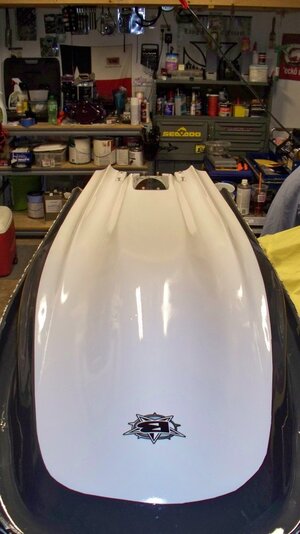

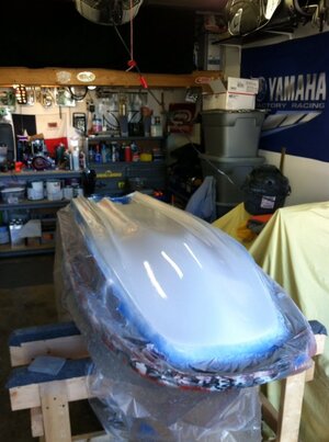

Wet, what was your temp and humidity if you recall? I used both white and now the black rustoleum appliance epoxy. I sprayed it while 85+ degrees and let sit for 2 days. my bottom was sanded with some 160 grit and acetone wiped down. then sprayed off with compressed air. it is hard as nails. I remember most of your fx1 build was in the somewhat cooler season no? sand it down and you "might" be able to use some dupli color adhesion promoter.. don't quote me.. read up on it. Ive used it for a lot of plastics and trim with good results. here is the white...
