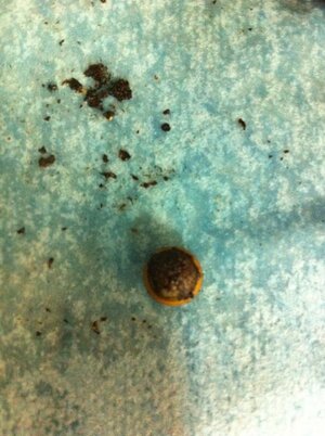

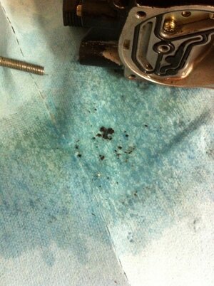

Well, well, well...interesting day realizing my stupidity. Pulled the carb and found this
I then measured the carb and found it to be a 40mm carb, the 38 was a spare that came with the ski. That explains the jetting that was in there. I had totally forgotten that I had no screen on the supply drop down tube and no filter on the gas line. I am replacing all fuel lines and adding the filter.
