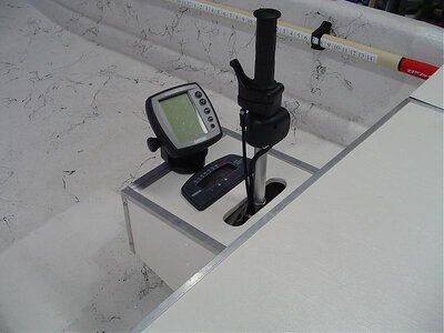

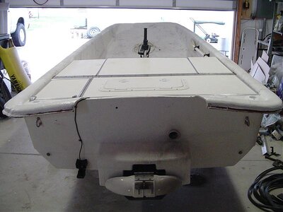

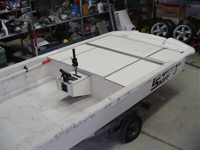

Someone gave me a VXR pro a few years back and I had always wanted to make a little jet drive powered fishing boat. So, I took a sawzall to the VXR and to a 16' Carolina Skiff and mushed 'em together. I did a couple of years ago and it just occurred to me to post it here.
It's kinda like a monster Jetmate (if anyone remembers them?) and it's a blast to drive. It's joystick control and cruises pretty damn good. I've wakeboarded off it and it deos about 40mph. It is also a blast to go over the shallow flats (in 6" of water) with crab traps sticking half out of the water and shredding them like buoys.

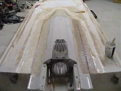

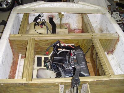

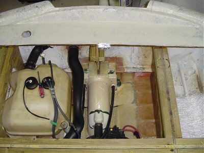

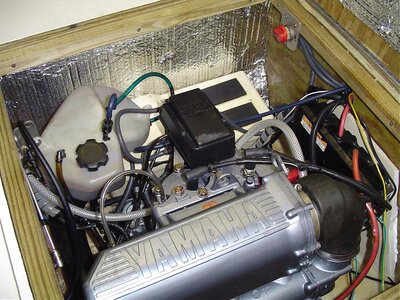

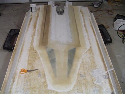

Some construction pics. It's not real pretty, but it was more of a prototype kinda thing to see how it would work.

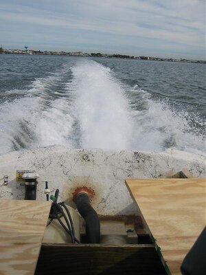

Throwin' some roost on the first test ride with no decking or seats. I just sat on a scrap of plywood and went for a rip.

thats nuts that you glassed the hull into the boat i didnt understand at first till i saw that picture thats awsome. i hope your in Cali i want to ride or have you come out to oceanside that thing would make a good wave jumping party deck:biggthumpup:

The boat turns great. At idle, it will spin around in less than it's own length. At speed it handles very well, but will slide if you push it too hard. It takes a little playing around to get a feel for just how far you can push it. I've had it out in the surf and it catches air pretty well. Almost pearled it once and damn near sh*t my pants, but it came out OK. It now sports an R&D aquavane scoop grate and that improved handling too. I think I might add a couple of small fins to the ride plate to get it to pull a little more "G" in the turns.
