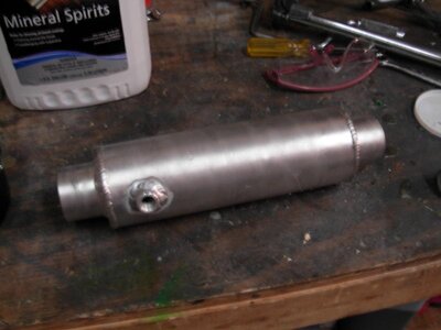

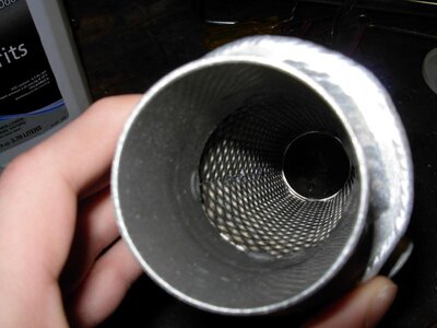

I rode it for the first time this weekend. When I am in the surf I won't care about the noise, but I'll for sure piss off everyone on the lake. Does anyone know where I can get an inline silencer? I've looked and they seem impossible to come by.
