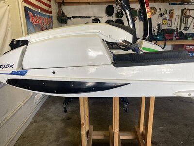

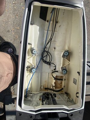

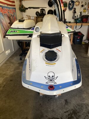

Starting a build that I wanted to share with you all! Also wanted some input. Open to any tips or tricks to squeeze every last HP out of it. Starting the build with a white 1992 550SX. Here is what Ive got so far
ENGINE
- 750 Big Pin ported cylinder and cases by Erickson Machine and performance. I’ve always gone with group K but wanted to switch it up.
- ADA Girdled Head (26CC 180PSI)
- Dual Mikuni SBN 46MM
- R&D Intake Manifold
- V-Force 3 reeds
- ADA reed Spacers
- Jetinetics Aluminum Flywheel
- Zeeltronic Ignition
- Factory B pipe.. going to try and squeeze the 750 pipe under the hood. If I can’t make it work I’ll use my 650 B pipe.
- Port Matched exhaust manifold
- 550SX TDR water box (haven’t purchased this yet, open to suggestions as I want to make sure I have enough flow for the 750)!
- I am debating on having crank works lighten and balance the crank. From
What I understand if you lighten it then balancing is a must! Im curious if any of you have had that done to your 750 cranks? It’s about $800. How much of a difference does it make?
HANDLING / PUMP
- Black Market innovation 750 pump conversion kit (X2 driveshaft).
- Wax racing ride plate (for 550-750 pump conversions)
- Impros Hooker, im thinking 9/15
-Pro watercraft sponsons front for sure and possibly rear.
- Jet Dynamics Top Loader for a 750 SX
- Cheap trim (X2 Nozzle) have to figure out a cable and lever. Planning to run cable through stock bilge outlet
- Lightened handle pole spring
- Nose brace and handle pole brace
I’ve got almost all the parts ready to go. Should be starting this week. With sponsons and pump conversion. I’ll be sure to share pics! Thanks! Im pumped!

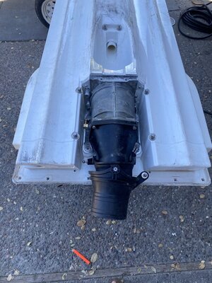

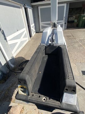

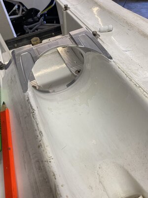

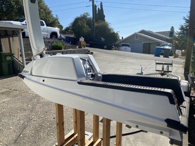

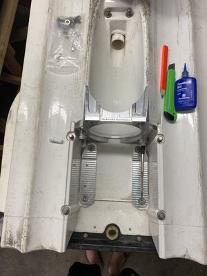

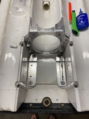

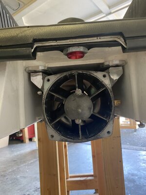

Got the pro watercraft front sponsons installed today! They make installation super easy. Comes with a Nice diagram, silicone, and hardware. Also got the pump conversion done as well. Had to notch the rear of the ski for trim clearance.

How was installing the pump with seal? I really fought with mine (rhaas kit) I am not super happy with how the gasket fit on the bottom side either now that it is installed. I will probably end up filling the gap with some rtv to make sure it doesn't puke water or suck air.
Sean
I was actually going to go with the rhass kit but it said out of stock and I didn’t want to wait. This kit uses only silicone, it all fit together very nice / tight and appears to have a great seal... but when I have to take the pump or intake grate off it’s going to suck to clean up the old silicone and reinstall. I

Ok that’s good to know, if I have any cavitation I’ll buy a 12 pack and grab the OEM gasket. As of now It’s just installed per there video. Seems like the lip on the pump shoe is to skinny for the gasket. Does yours hang off or did you trim the gasket?

If you opt to use the oe gasket, try and knock the corners off the shoe mount with a flap disc and lube it up with some silicone grease. I also found it helpful to "glue" the gasket to the pump with some rtv. Even still, it was a HUGE pain in the ass.
