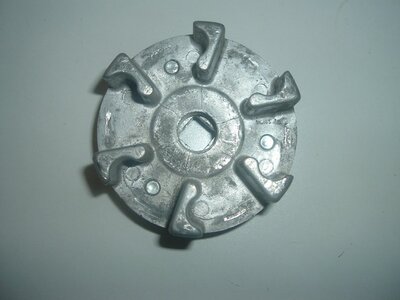

Does anyone know how to remove this?

How to remove the coupler? You need to put the crank in a big vice, possibly with a towel or something like that around it so it doesnt get damaged and then you need a long straight piece or a super long wrench to stick through the coupler to thread it off.
Thanks, I'll try it today. Which way should you turn to loosen it?

Have not managed to get away coupler, will try to warm up and see how it goes. I'm upgrading the cooling as fast as I can! But do you have to upgrade the cooling for it to cool properly?
