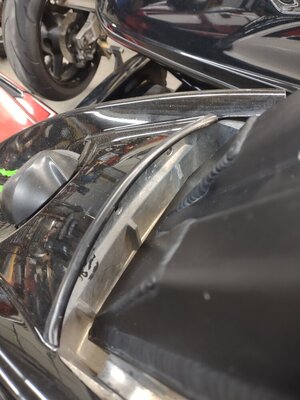

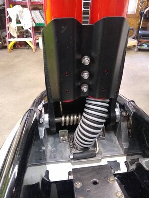

I cut the upper turn off from the spring when I installed my KP on my SXR. I also added an additional pole pad otherwise the pole hit the hood. This is the only picture I have available. I'm not sure if the KP is heavier than stock, probably, but I would never go back to stock after using this setup. It's all around better.

I think I see the big problem I’m having, after seeing yours I think I need to slide the poles back into the bracket more to give me room to work with.
I’ll then cut the turn off the spring.

A good pole spring will make the pole feel light. Definitely push the poles back up into the bottom pole bracket. I've had much better luck installing those type poles in pieces vs trying to it preassembled. Get the bottom on first, the run your cables up, the then the poles an finally the top portion. Wait to tighten everything once it's together to make any final adjustments.

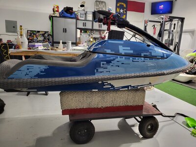

I like to make a pole pad out of undermat then turf it and glue it to the hood. You can easily shape the undermat to fit the hood curves for maximum surface contact and adhesion.. I made one for my superfreak that is 6 inches tall and it finally blew off after 2 years glued on and a failed barrel roll where I landed upside down at a 45 degree angle nose first. I can't imagine you'll be doing anything luke that with an sxr.

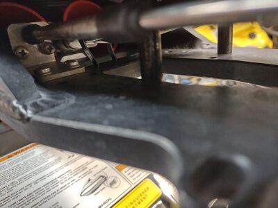

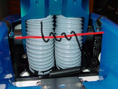

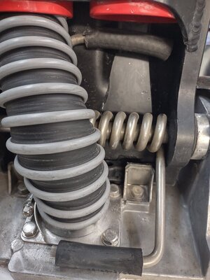

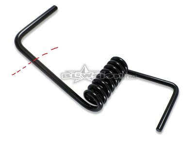

We have an RRP pole, but it looks kind of the same. We cut the end off the spring.
In this pic it shows the location of the pole bolt and spring position behind the tubes.
On our setup the end of the spring where you cut it off sits under the flexible tubes, it doesn't go into the hose or tubes.

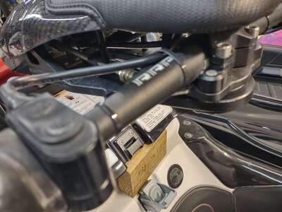

I used a blowsion sxr spring on my superfreak and cut the top as well. Also had to bend the bottom a little as well. It has a xmetal pole which typically uses pinch bolts but I like the pole spring feel over the tight pole.

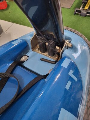

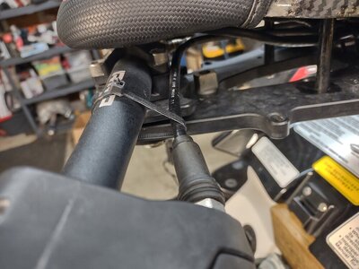

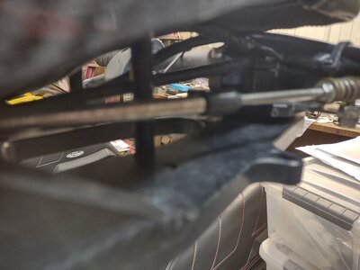

Curly, I mis-spoke. I re-bent the top of the pole spring and cut the excess off. I used the stock pole stops but did not use the rubber bumper. I took some pics of the steering assembly but did not know what you were specifically looking for.
