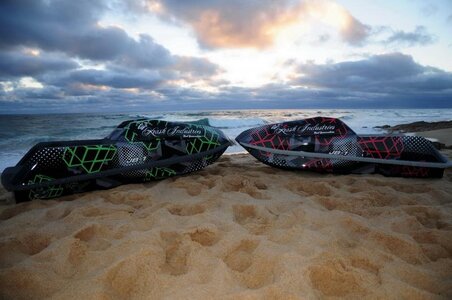

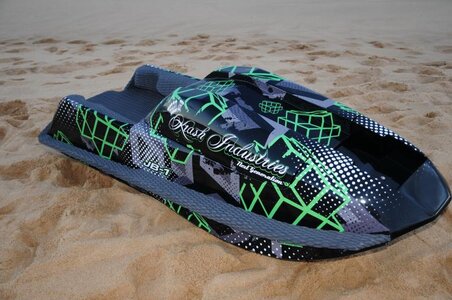

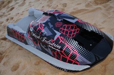

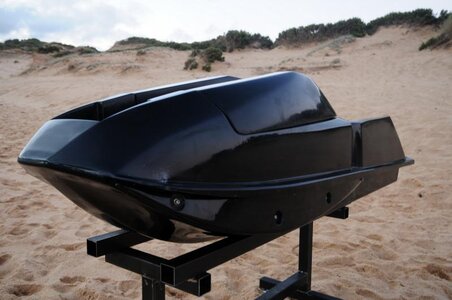

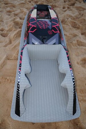

Hey Im Nick Barton and these are the hulls im building in Australia for freeride and freestyle. Pics By Gavin Lawley

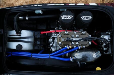

Nick it looks like you threw a Rickter, a Matrix and a Super jet in a blender and thats what came out! No worries though, it looks good. How do they handle in the surf? They look like they would rock but the motor picture you posted with the small gas tank looks like a flatwater set up. I'm assuming there are different set options?
Australia
Thanks Zack you will have to have a ride when you come out. Yeah it handles great in the surf the bottom curve is the most unique part with built in sponsons and attachable ones it runs similer nose rocker to surfboards and a larger pump cavity. Wider trays, lowered hoods and shorter skis your right everyone is doing that now but you would be crazy not to they make alot of difference in the surf. The engine pictured is an Sxr 800 with a kart tank, they are just easier to work on and where we ride its easy to fuel up on the beach each hull is universal running superjet or kawasaki drive trains to give people an option as kawasaki make great running gear and in a hull thats 45 kg compared to an 80kg kawasaki hull they to have great bottom end punch.

That is the most sano looking engine compartment I've ever seen!
