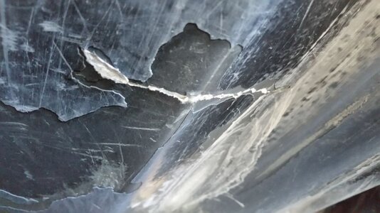

(another month goes by) Getting my ski ready for a little get together on my lake, I was replacing some turf, the factory turf was starting to get a little beat down. I had the ski lifted up at and angle, so i looked at the bottom to see the condition of the paint... I saw water dripping from the bottom of the hull, I found two cracks on the bottom, under the engine (sickening). Well $#*$, I have to fix that before this weekend, so i flipped the ski, and while i was there I fixed the leaky resin spot on the bondrail. The hull made it almost a season and a half without cracking, not too impressed, I was never harder on this ski then my superjet. My superjet made it threw many years of riding, with not one crack, but i did reinforce the hull. Oh and this Footrocket has the "Surf Layup"...

The paint looks bad on the bottom, that's because i painted bottom during the off season(Paint was a little scratch up from the 1st season), but messed up on my prep, so it is coming off in chunks.
Crack 1
Crack 2
YES! I always wanted to cut threw the side of a high a/m hull...
