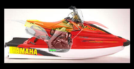

I put some serious thought into making my own blaster hood last winter. Mainly to increase strength, but I also wanted to raise the steering and change the styling. One thought I had was to perfectly mimic the scale and positioning of a mx bike. Well, after scaling some photos (honda something or another 125) and overlaying them with photoshop it turns out that even a stock blaster has quite a bit in common with a bike like this. The only real difference is the steering height. The center of gravity is a bit different too, but only with relation to the ground, not the rider (which is more important for aerials). Another thing that will affect aerial tricks is the distribution of weight (ie moment of inertia). The hull of a blaster makes its weight much more spread out than an mx would be and that inhibits rotation. The extra 100# isn't exactly helping things either.
Note how the seats line up perfect and the green line I drew through the peg is just about exactly at the height of the gunwale. Raise the steering and it is almost a perfect match. Coincidence? Not likely.
