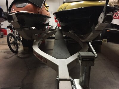

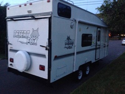

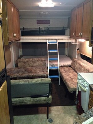

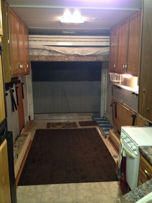

I have wanted a toy hauler for a long time and last night I finally found one I could afford. I think I can put a single trailer converted to a double stand up trailer inside of the toy hauler. However, the load height is approx 4 foot with approx 8 foot ramp. The ramp is too steep to push 1000 pounds up. The idea would be to drive to the east coast, park the toy hauler at the camp ground and use the single conversion to ride and keep sand and salt out of the camper.
Does anyone have a toy hauler and load something like this? Current thoughts are to jack up the ramp to extend out the load angle, or to try to get 2 boats in the bed of my truck and put only the trailer in the camper.

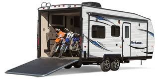

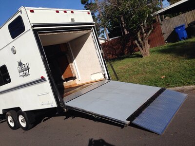

There are plenty of Toy Haulers that are not converted enclosed Car Haulers or Cargo trailers. They have a rear loading door which makes for easy loading. There are other kinds of Toy Haulers that have the side entry like what it sounds like you are talking about where the entry ramp is shorter and steaper. I borrow a Regular Toy like this upload_2015-11-17_12-52-12.jpegand can load my ski with it still on the shop stand. Then you have these type which sometimes has the extendable ramp to make the ramp not so steep and some do not have this part, so your ramp is really steep.

That is the same as I borrowed. Not 4' off the ground. ;)
