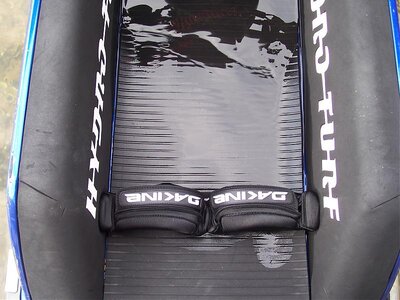

Each strap Has 6 holes for screws, I went to boaters world got
12 #10 1 1/4 length stainless steel panhead scerws, put the straps in the postion I wanted marked with chalk. youll need A drill bit A couple of sizes
smaller than the screws you Are gunna use, PREDRILL YOUR HOLES, If you dont they will probly break the fiberglass from being to stressed.then just screw them down. they work great ive used them for A couple of weeks now and ive had no probs at all Good luck let me know how they turn out.

Just Wondering On Postion Of The Straps... Side By Side Of Staggered 1 In Front Of The Other?? Im Use To Surfing For The Past 15 Years So The Side By Side Seems A Bit Ackward..but You Guys Would Know Best Im Here To Adapt.. :)

That seems like a bad idea of a way to connect them... screws in fiberglass over a short period of time I can see that ripping out, leaking, and just overall being a bad idea.
That's why I wasn't sure the best way to connect those straps... seems like the right way would be to cut out the turf in that area where they connect and do some type of countersunk "anchor" that you screw into, glass over it or expoy maybe? Either way, it just seemed like a major PITA and I'd wait to install footholds.

surf stance!!!!...screws work best...glassing in the acorn washers dosnt work...ask oxnard111...
just put some silicone down before you drive the screws...ive still pulled out screws but they last awhile
