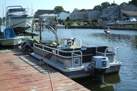

I used to just drag em up, but we needed 2 people. My boat was also a solid fiberglass top and bottom, not actual pontoons.
You can see that crank I mounted on the deck, It didn't work like I planned so I yanked it out. I even tried mounting slippery plastic starboard on the side of the hull to get the skis to slide up, but that didn't help. You will need some sort of a ramp or bunk system to make it possible for one person to lift on the boat.
