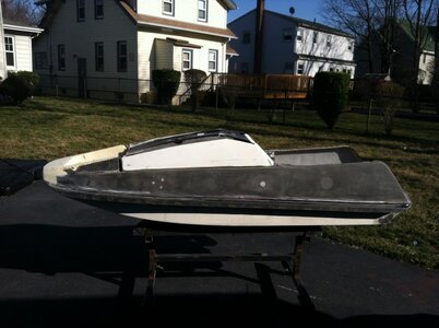

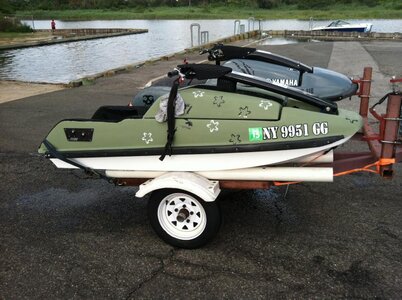

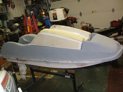

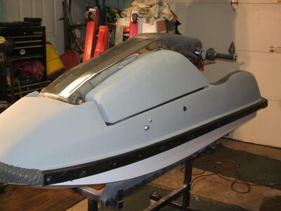

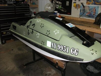

I've done two of them here. The first one we just cut a little off the top. The second one I cut just a little lower than the stock center hood strip where the pole rests. I think the lower one looks way better, but I also changed the pole bracket area on that ski so the lines were a bit different.
I think you should build it as low profile as possible. Keep the sharp lines and square look like you did with the fixed steer hood. I think that came out great.
