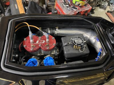

Just received my hull so decided to post up the build on here.
Setup :
LSP revolver v2 , ordered thought HSI
Adjustable foot holds

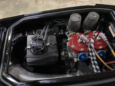

ET900x comp motor with additional porting
Full spec 49s on php intake
T/L zeeltronics
PFP exhaust with RRP waterbox (been running it dry but plan to test it wet)

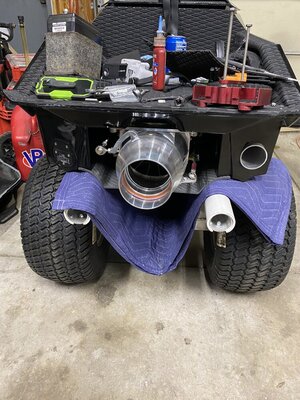

Thrust setback 155 pump ,long thin cutback skat
LSP Lee stone trim
XS LSP length pole
I cheated and had LSP install the pump shoe , align the pump and midshaft along with having them turf it.

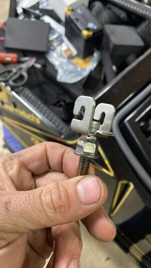

Decided I didn’t like how my fuel pump was mounted before so built a mount off the two rear speed plate bolts. Made from a piece of stainless plate.

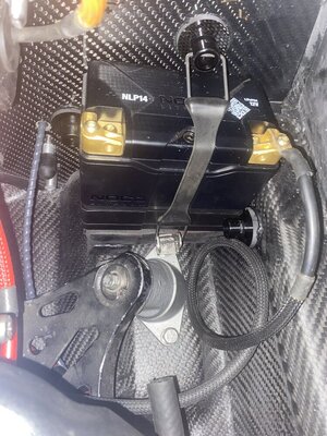

Welded a m6 stainless nut to motor mount bolt for battery strap.
Got the tank turfed , and everything reinstalled after test fitting everything.

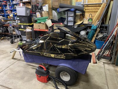

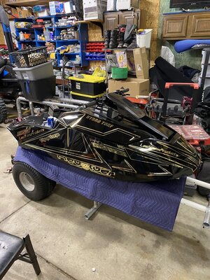

Got the rest of the ski assembled. Everything around here is frozen. Hoping to make a trip about 5 hrs south to ride on a lake that provides cooling for a coal power plant. 60-70 degree water temp in winter.

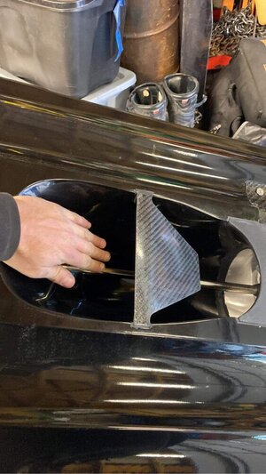

Couldn’t believe the pump tunnel size . Much larger than my old xfs.
