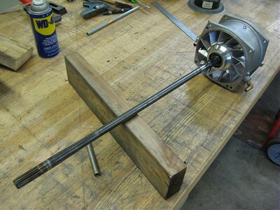

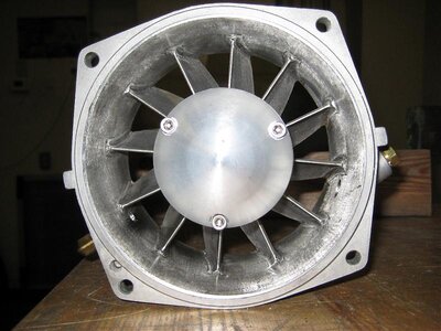

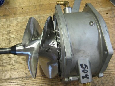

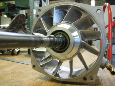

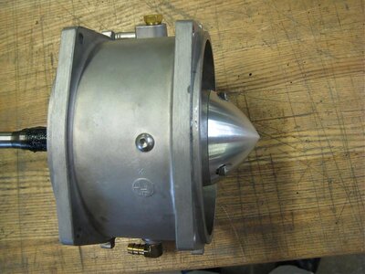

I got this Skat-Trak Mag pump as a sponsorship/loaner from Precision Powersports in Ft. Worth, TX (Kaveman on here) :Banane09: I'm pumped, I'm going from street tires to slicks :fing02: This is the 144mm 12 vein version, which should help get more horsepower to the water :bigeyes:
Anyway, I was just a little excited so I thought I'd post up some pics....it's SEXY!

I can't give you a fluids class on this, but the main differences are a larger hub, more fins, and better surface finish. Larger hub keeps pressure higher which leads to better hook up, more fins redirect flow more efficiently, and the insides are finished unlike the crappy casting marks in a stocker.

Yes, this one weighs 12.35lbs fully assembled as it is in the pics above. I don't have a stocker here to compare.
Nice... what's the button head allen bolt for on the top and bottom?
I think they are there as a safety to keep the stainless insides from spinning in the aluminum housing.

A wise man once told me that the stator viens are straight and closer to the back side of the prop and this is where a large portion of your efficiency comes from. I told him I didnt care where it came from IT SIMPLY ROCKS on my boat. P-Diddys analasys of street tires to slicks were EXACTLY my findings when I bolted up the 144 Mag to my boat, I will never go back to a stock vien housing. I do want that stubby cone on your mag though p-diddy, mine is much bigger.

Is that a set back? Are the set backs good for freestyle? I always thought they were more for racing.
