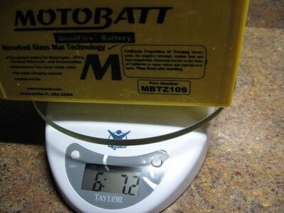

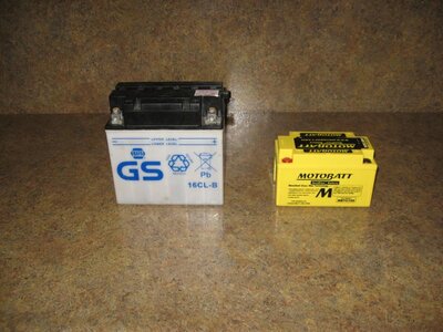

Check out the new battery i picked up for 72 dollars. not much info on the net about this brand, but still decided to give it a try. it's called MotoBatt and weighs 6.7 lbs. @ 190cc. the Napa battery i had weighed in at 14.8 lbs. @ 280cc. also purchased a TecMate TM-151 Desulfating Charger/Maintainer. All I have is a MSD enhancer and oem choke plates, so hopefully that’s enough CC’s...first time posting vids, hope they work... (Billybo, it measures 5 7/8"L x 3 3/8"W x 3 3/4"H)

I actually purchased the Deka-9 back in Jan. 6.8lbs @ 120cc. when it couldn't start my ski, i thought for sure it was because of the low CC amps. So I found this MotoBatt @ 190cc. of course this one didn't start my ski either…that’s when I started trouble shooting looking at the cables/relay/starter, etc… cool find about the test, guess time will tell if i picked a good brand...
