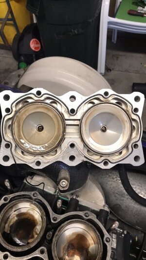

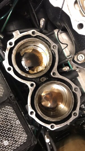

I pulled the head before. The rear cylinder looks like the problem and looks milky. I checked the ada head rings and the shell isn’t worn. Maybe the water drained back from the head pipe?

A bad CDI will still give a spark. Did it come out of his running ski or out of his garage?
Out of his garage.
