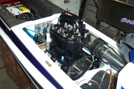

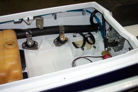

I am new to the pwc obsession so this was my first attempt!
still frozen here so I haven't ridden it yet
1990 js 550 sx /650 conversion
jre conversion plate
single 38mm keihn
primer kit
stock exhaust /modified
gutted water box
bilge pump
rotary bilge switch

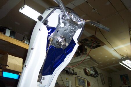

pjs quick turn plate
pjs bar's odi grip's
o.p. extended finned plate
r&d toploader
15/20 solas

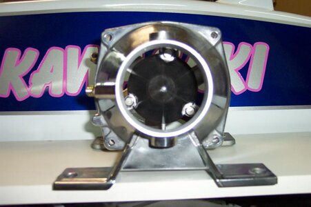

blueprinted & polished 550 pump
bored nozzle
pjs steering nozzle
custom base clear pearl paint no decal's

This is the finished product It was a really clean ski to start with and I am real happy about the way it turned out quite a few member's from pwc today helped me with tech and some of my dumb question's

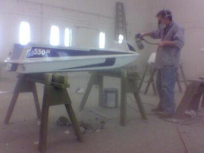

i was leaning towards painting my engine bay idk if it would have been worth the sanding to do it right.
Did you sand it or just throw over some primer and paint it.
again looks great man.

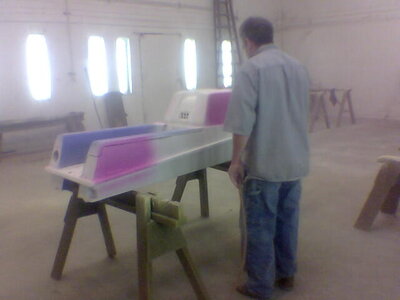

I use a red scotchbrite and then ppg epoxy primer dp-40 then cover it with base / clear otherwise you can end up with the flake off issue then you gotta mess.
