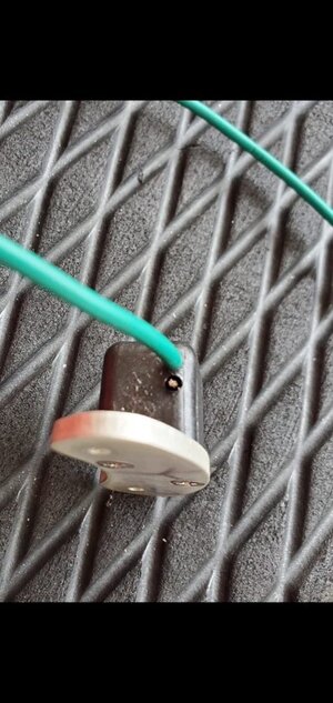

Not s fast! Again, my experience! Change the trigger! They can and will fry the brain!
This is how most triggers short out, ( see pic below) If you changed the brain, but left the trigger?
My guess is you will loose another brain in a fairly short time span!
