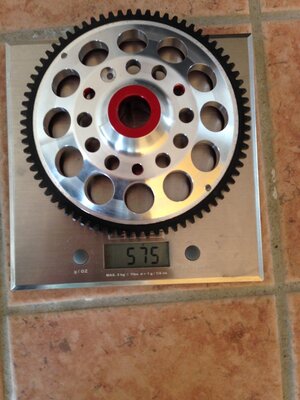

Has anyone run one of these MSD Total Loss Light Weight Flywheel's? I have a DVX with PHP 898 and MSD TL currently. Obviously expensive, but so is flat water ski life... Do they ever break being so light?

I've lost track of how many original MSD flywheels I've seen crack over the years. No way I'd trust a Swiss cheese version. Especially if it isn't rebalanced.

Been running a zero lightened msd flywheel for a season and a half, all good so far. Make sure to get the ring gear pinned because they eventually spin. Zero does this also.
