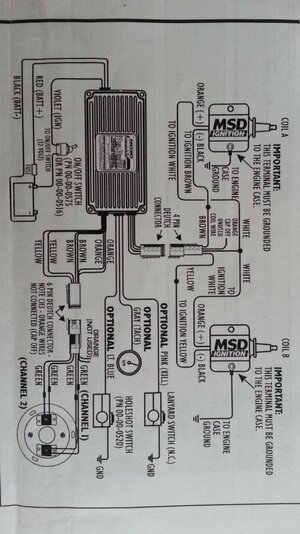

Msd wiring diagram.
Stockton

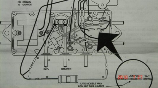

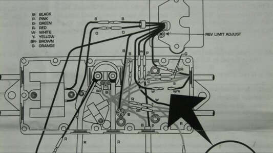

image.jpg image.jpg MSD enhancer, if you mix up the white wires you get no start then fires when releasing the start button momentarily. No spark while crank then spark As start button is released
