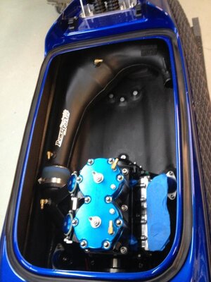

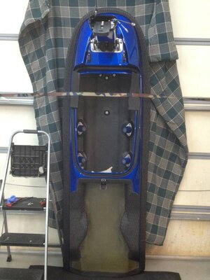

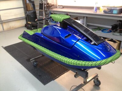

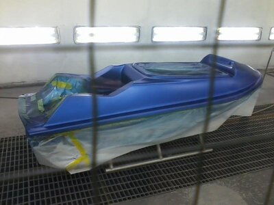

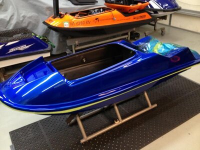

The hull is a standard production KDX. With engine mounts and after paint, it weighed in at 47.5 pounds. The hood is slightly over 8 pounds. Standard with this hull are two scuppers (one on each side), a sweet carbon ride plate, carbon hood, pump shoe, and all inserts per your build. All hardware is metric, and off of a std superjet. No mixing of SAE and metric on here. All std superjet parts will bolt right in.

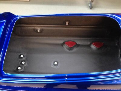

The fit and finish is unreal. I am OCD and very detail oriented, and can't find a single issue with this hull. The craftsmanship and appearance are the best I've seen on ant production hull. The motor mount pads are spot on, as are the tank and pipe inserts. The pump area is prepped and ready for install, with the inserts leveled off and tried up at XS. All of the water lines (and exhaust tube) are anodized for corrosion protection, as are the motor mount pads. The tray is carbon Kevlar reinforced, and the footholds are awesome with tons of room for padding and big feet. One of the XS guys challenged me to find a sharp edge inside the hull, and I couldn't. He explained he had a few hours deburring and finishing the inside to alleviate the issues of carbon splinters for their customers. The attention to detail shows. When I asked for a quote, Rick said "we consider these works of art, not just hulls". I thought that was a BS sales pitch, but the finished product shows that that vision is real!

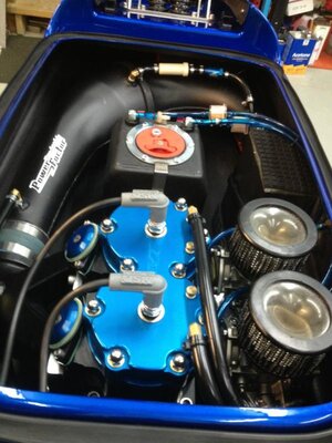

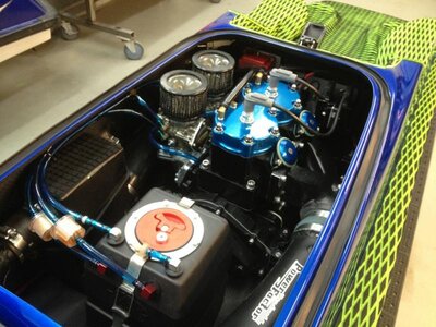

Current setup (and for the season) will be a Dasa 10 mil 885, Powerfactor pipe, 49 Full Specs from Ed Brazina, MSD Total Loss, Rhaas products' new billet urethane motor mounts, and a 148 billet setback mag. It will be built and tuned by P&P Performance.
Thanks to all that have made this possible, including Kyle Kennedy@Dasa, Pat, Jason, and Rick at Xscream, Mike B@Optima Racing, David@impros, and Robin@Rhaas products.
Here are some pics to get started. I'll update as I have time. It's a mad thrash to get ready for the 60 degree day Saturday, before it snows Sunday lol. Hopefully I'll be off to FL for some training/warm weather riding for spring break. ImageUploadedByTapatalk1363924794.192665.jpgImageUploadedByTapatalk1363924827.322245.jpgImageUploadedByTapatalk1363924854.458452.jpgImageUploadedByTapatalk1363924871.859956.jpgImageUploadedByTapatalk1363924889.676807.jpgImageUploadedByTapatalk1363924904.195602.jpgImageUploadedByTapatalk1363924916.510252.jpgImageUploadedByTapatalk1363924928.064064.jpgImageUploadedByTapatalk1363924972.444496.jpgImageUploadedByTapatalk1363925006.324858.jpg

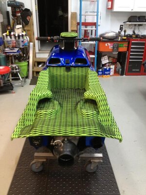

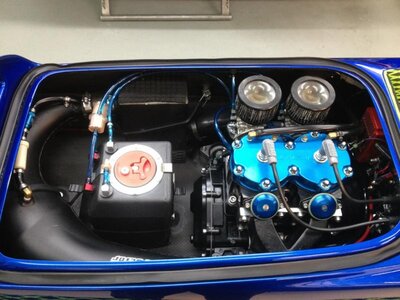

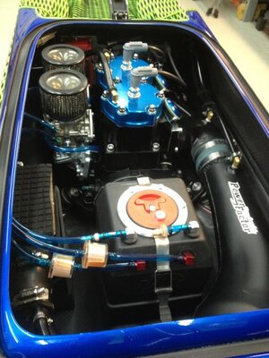

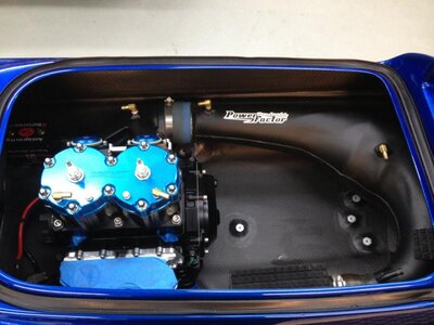

Ski is complete and 90% dialed in. Still pump tuning but it's close and working well! Rode a few tanks yesterday and I am more comfortable on this boat than I thought I would be this early on. All of my past tricks are easier, and look smoother/cleaner based in witness comments. I'll update with some video as I get more time on it.

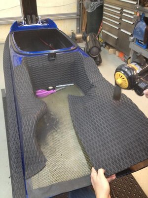

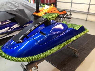

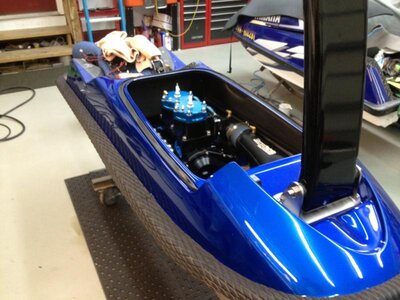

The boats final assembly went smooth, and everything fit great. We did re turf as the molded was just too hard, and lacked "pop". Think we got that covered now ;). Looking forward to some warm Fla weather later this week, and some riding with the XS crew. Stay tuned!ImageUploadedByTapatalk1364784574.813391.jpgImageUploadedByTapatalk1364784584.898678.jpgImageUploadedByTapatalk1364784594.411007.jpgImageUploadedByTapatalk1364784606.504858.jpgImageUploadedByTapatalk1364784616.376525.jpgImageUploadedByTapatalk1364784626.896987.jpg

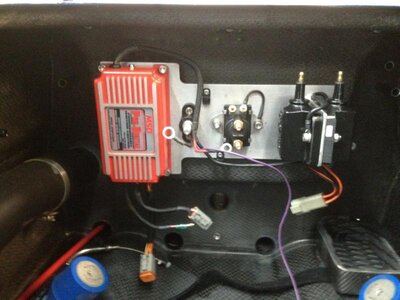

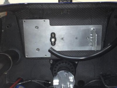

Some close ups of our custom P&P Performance parts we made for this build. For those that don't know, the other "P" is my wife Penny. Couldn't do it without her!

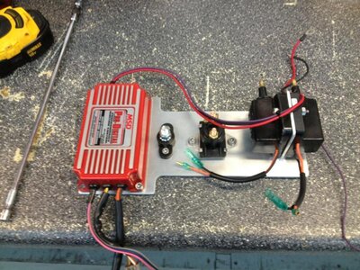

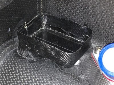

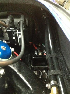

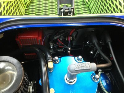

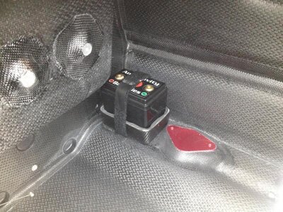

The Msd plate was mounted to inserts that we used and mounted to the bulkhead so we didn't have to drill holes in the hull. Plate uses countersunk Allen ss hardware and is threaded, for easy component change out if required. The carbon battery box (first shot is just the mold and is rough) is bolted to the floor and tucks the antigravity 12 cell away nicely. It is designed for a layer of turf inside to protect the battery. Its a tight fit and i coukd almost run with no strap. I will be running a 16, but the 12 has been better than expected and is more than enough for this high compression 900. ImageUploadedByTapatalk1364786225.350836.jpgImageUploadedByTapatalk1364786244.330998.jpgImageUploadedByTapatalk1364786278.062218.jpgImageUploadedByTapatalk1364786355.386715.jpgImageUploadedByTapatalk1364786382.333628.jpg
