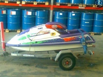

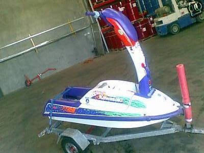

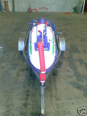

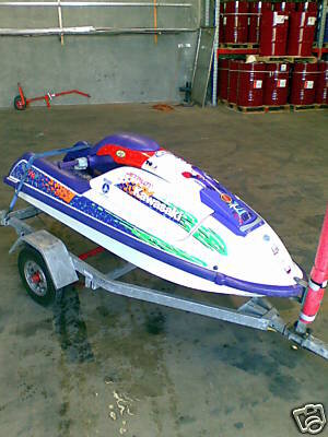

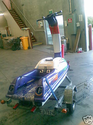

Hi Everyone. I have just bought my first pole ski. I would like to learn freestyle in the surf. I live in Brisbane Australia. If any one has a riding group on the weekend let me know I will travel up to two hours. I have attached pic of the ski when i bought it. The ski is currently being striped and will be re-gelcoated in either bright yellow with black accents or silver with black. Current modifications are factory pipe aftermarket carb (Kennith), Ocean pro rider plate and intake. I will be installing new foot holds, hydroturf and twin carbs next. I know every one has superjets for freestyle, but i want to try both and see which on I prefer. Thanks guys and feel free to leave any comments.

save your money on the duals. 750 engine does not need to have dual carbs. Ignition advance and lightend flywheel is all that is needed. If you have the blue keihin, keep that carb, its the best one for the 750's. Bump up your compression and your all set.

if you plan on surfriding run footstraps instead of footholds..much more functional for surfriding..good luck with your ski...

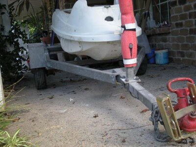

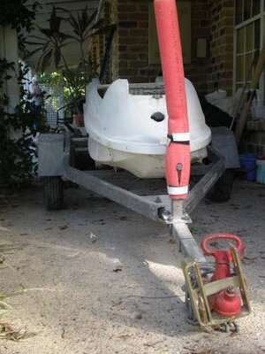

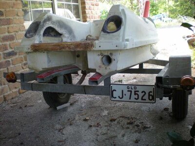

I got some more pics (took for waxhead to show him my trailer). Tubbies on footholds cut and will be on soon. Ski will be painted this coming week. I'm hoping to get it in the water before Christmas. Thanks again for the input guys.
