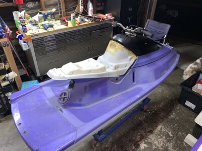

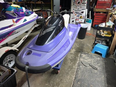

Sup guys, this is my first thread on the X, I’m new here and wanted to share my ski I’m working on/kind of building. It’s a 94 WB1 I picked up off Craigslist. Thing was sitting outside for years but the hull was pristine other than fading paint. I had a raider motor sitting around I wanted to drop in there for some brap because my other blaster isn’t fast enough for my liking... here are my plans with her:
62t/62t raider motor bone stock
Coffmans pipe
Solas 9/15 impeller
Ocean pro ride plate
Ocean pro intake grate
Pro tec +20 nozzle
And a bunch of billet goodies

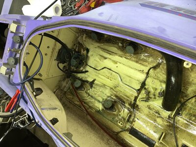

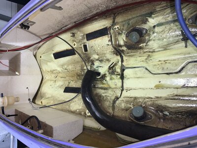

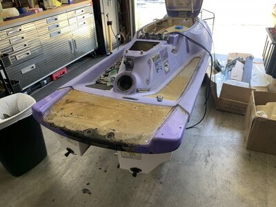

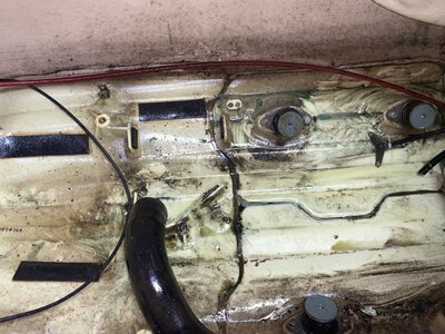

The inside of the engine bay before and after I cleaned it for a while.. the factory oil tank hose cracked and leaked oil all over the hull

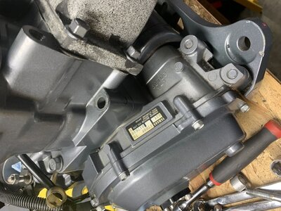

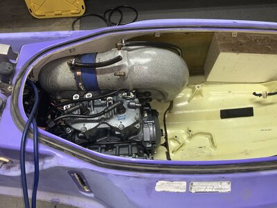

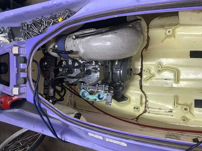

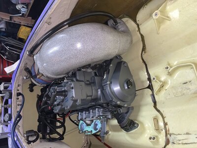

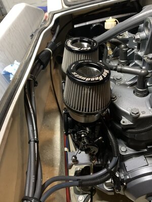

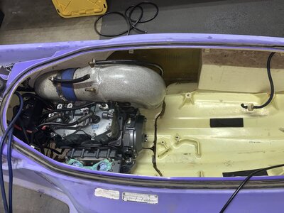

Dropped the motor in to shim it up and check fitment

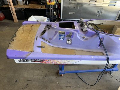

All the turf and old faded stickers pulled off

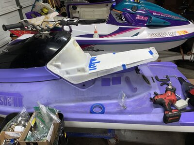

Since I am only waiting for my carbs and pump to be done at jetworks I got bored and decided to do the seat mod.
Pretty easy honestly, I pulled the old cover off and took the foam and styrofoam off and started mocking it up on how want it to look and how much to shorten it.
Then it was a bunch of cutting, grinding, and fitting until I got something that looked nice.

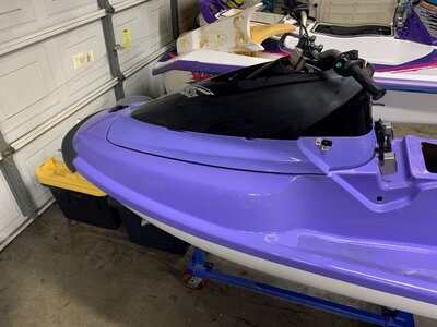

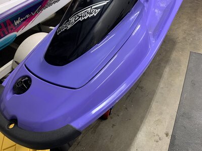

So I had a few hours before work tonight and was able to knock out the color sanding. Will probably start buffing tomorrow then install the turf and all the billet goodies.
