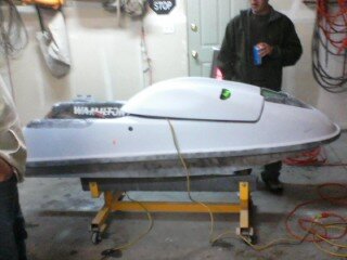

Ive been working on this hull for the past few months the nose was busted off and the bottom was kind of repaired. It is all looking good now. It has wamiltons foot hold, Blowsion one way valve, I put a 24/7 sr22 hood and nose piece.
Plans on the motor is 62t61x freestyle ported, Single carb 46mm, Vforce reeds, ada head with 33cc domes running 180psi, Factory b mod pipe, 9/15 hooker prop, and xmetal trim.
