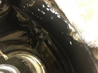

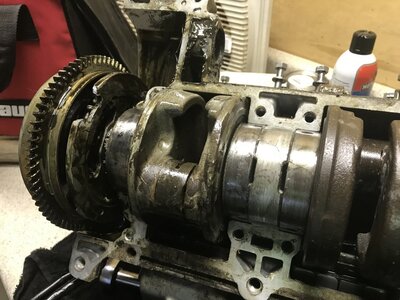

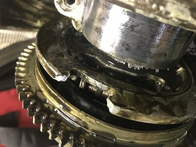

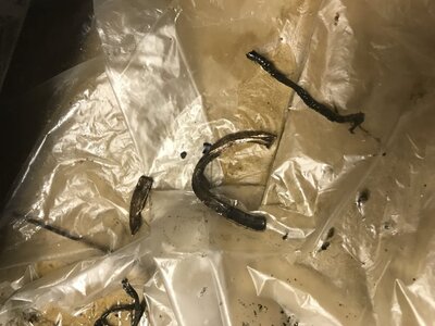

94 SJ 701. Just bought the damn thing last summer. Part of the stater busted off and what looks like a bearing racer fell out when we pulled the oil pan off. 3 of the 4 motor mounts were hosed as well. Suffice it to say, this one is going nowhere any time soon. Probably just going to cannibalize it for my 650 (already did that for the carb). I might also try my hand at a Yamaslut hood mod on this one first. Already popped my fiberglass cherry on the 650 hull. I'll post that separately. 20190710_022808463_iOS.jpg20190710_022814285_iOS.jpg20190710_022837240_iOS.jpg20190710_022848473_iOS.jpg

Whatever the hell the bottom of the block is called. The crank wouldn't budge, so there wasn't much for it. I'm new to this whole thing so don't know what all the parts are called. I pulled the cover off of the stater, then pulled the mounts off, then the bearing cage or whatever. When I pulled the cover off the stater, it was already broken. When we pulled the block apart, we saw the bearing racer. I haven't pulled it apart anymore because there's really no point and I've been focusing on my 650 and waverunner. I priced out fixing this one and it's just not worth it. Looking at ~1400 just to get it running.
Confused by this also. The stator would have been easy to replace and would require the engine to be scrapped.
Maybe so, but the crank still won't budge and when we pulled the block apart, the racer fell out. I haven't seen the extent of the damage, but it's locked up somewhere. It's not just the stator.
I gotcha, didn’t see it mentioned in the OP that it the crank was locked up.
Oh yeah. My son tried cranking it out at the river and just heard a nice "clunk". When we got it home, crank would wiggle a little, but I think whatever is in there has wedged itself nicely. I'll eventually pull it apart and see what's what. But right now, no amount of engine rebuild is in the budget anyway.
