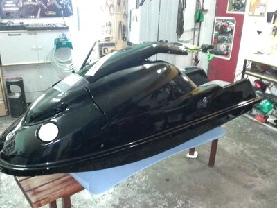

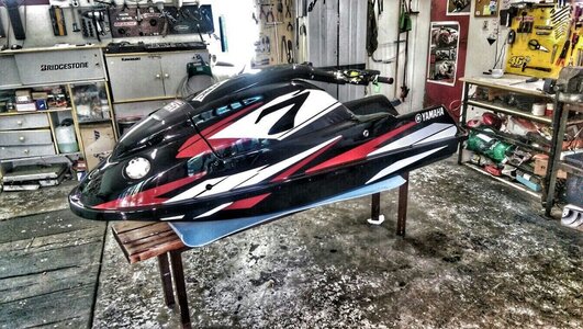

My rn superjet build
Croatia
I am sorry for my bad English

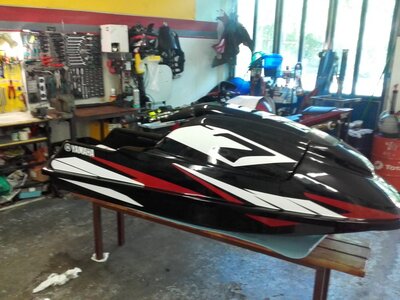

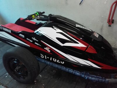

I will find picture of hull when i was buy. Guy make jokes with me and he laffing:)

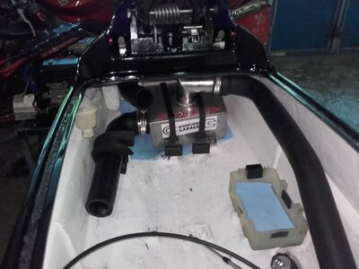

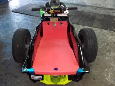

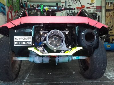

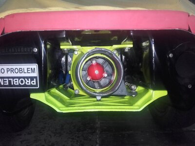

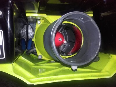

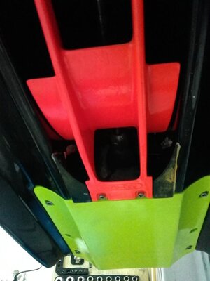

I make wide tray
Open holes rear for water flow and it is great in cornering and very good. No sponsons need i love hard turns

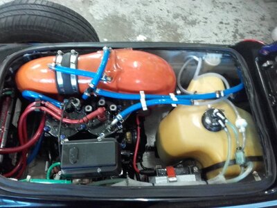

Coffman rocket pipe
6m6 ported case and 61x cylinder also ported and pistons is 82
Mikuni sbn46
inox waterbox
Eletric bildge

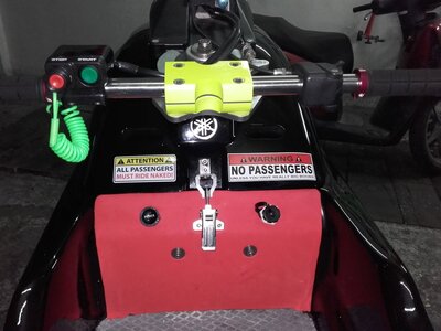

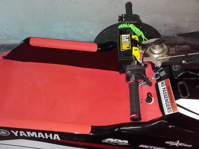

Short pole
Intake grade pro tec and steering
Great to ride and very agresive in cornering

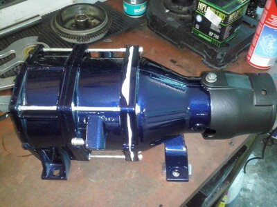

Preparing 64x on 62t cases

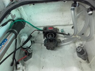

Stock bildge delete and dual cooling set. Coffman work much cooler now. I put second hose from pump to elbow no in manifold and can have one more pisser:)
