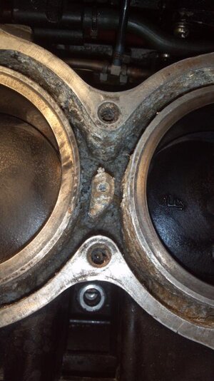

Anyone know anything about this secretion i have in my water jackets? I dont know if i should try to clean it out and risk some of this chit getting in my cases.2013-03-25_19-07-11_966.jpg
The anode is eaten up by the corrosion instead of the metal cylinders yours is missing small piece that's screwed in between t the cylinder s

I ride salt and took the anode out so it would not corrode and break apart which could clog my cooling lines. But I flush with Salt Away after every ride. 3.5 years after I took the anode out there was no crusty crap in the cylinder sleeves.

a lot of the time the screw that holds the anode in loosens and the anode in somewhere in there you just need too look for it, it takes a long long time for them do completely be destroyed
