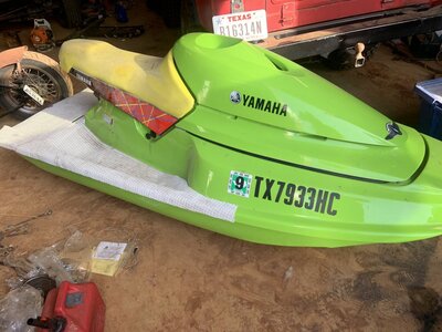

I am going to help my buddy build his blaster. He bought a Raider and not sure what we can use.
Does the raider exhaust, pump, mid shaft, and steering cable inter change? Any suggestions will be appreciated!!

The hull seems solid. Carter B rocker front and back. It came with a box of parts, some useful some junk. We are going to get started this week.
Wisconsin
With the stock motor mounting location I could not fit the raider exhaust. That being said, if you move the motor forward then you could make it all fit. Then the midshaft could work if you moved it correctly. The midshaft is longer and so is the drive shaft, the tank won't fit either but I think that much is obvious.

Good to know. I was hoping the drive shafts would interchange... I have a blaster shaft but has bad bearings
