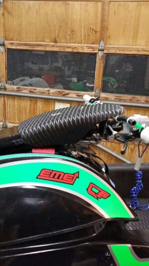

Dmac80sc
Here
I run the cold fusion fat bar steering. It uses the oem bushings so you never have to worry about bearings. I will say it a different feeling compared to a bearing set up, but for simple inexpensive steering it works awesome!
I did have to drill out the center hole, but not the 4 holes.
