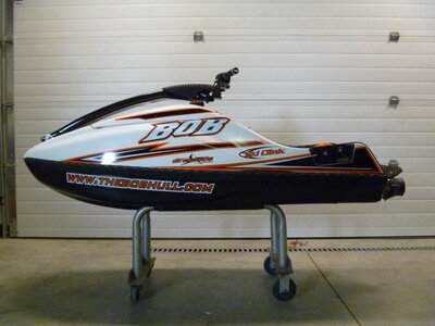

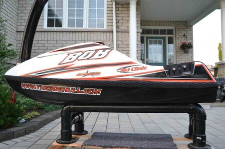

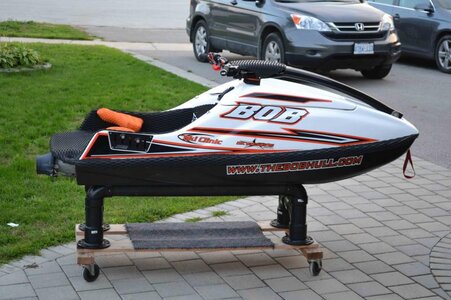

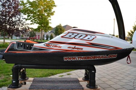

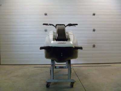

Just though id share my new ski I just picked up from the shipping dock today.
Bob gen 2 70lbs

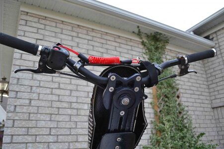

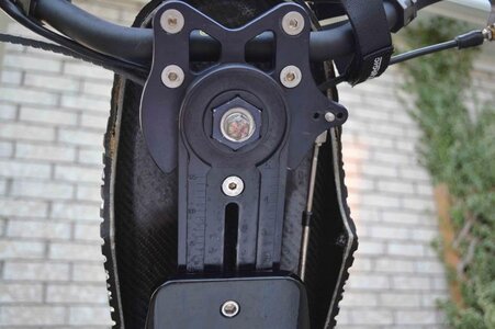

-X-metal adj. pole
-X-metal pole bracket
-X-metal stearing
-X-metal trim
-Wamiltons finger throttle

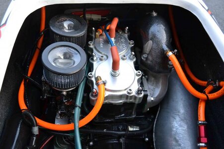

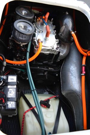

-62t cases
-61x cylinder
-re-sleved with watcon big bore sleeves
-ported & epoxy cases
-twin 44 mikuni

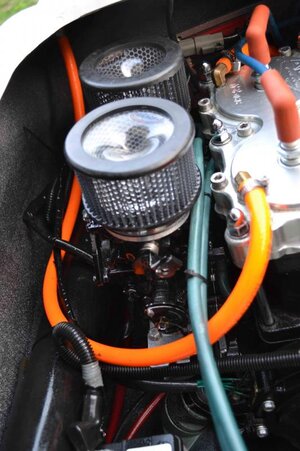

-proK air cleaners

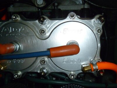

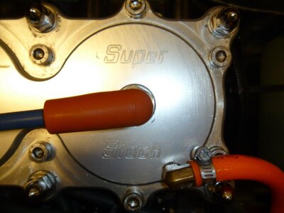

-A.D.A 785cc big bore head
-35cc domes 180p.s.i
-Factory b pipe mod
-impros 12-17 hooker
-worx intake grate

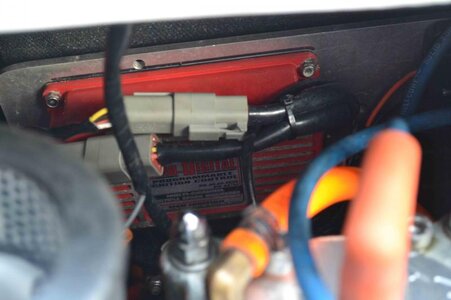

-M.S.D Pro Digital Total Loss
-2.5 Gallon kart Tank
-Jet Works flow control valve
-Pro Taper Bars1 - Copy.jpg2 - Copy.jpg3 - Copy - Copy.jpg4 - Copy - Copy.jpg5 - Copy - Copy.jpg8 - Copy.jpg9 - Copy.jpg10 - Copy.jpg11 - Copy.jpg12 - Copy.jpg

Oh yeah, rode her all day yesterday and today.
Wow.
Hull rode extremely well, very flickable, and will FW flip with some practice.
Felt very light and so much power I don't know what to do with.
The pump/prop/engine/ set-up is matched perfectly, and couldn't be happier.
Just installed pole limiting strap today. So will make some flip attempts soon.

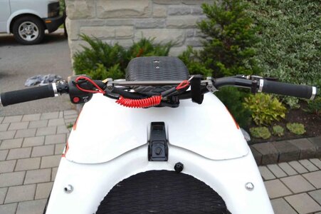

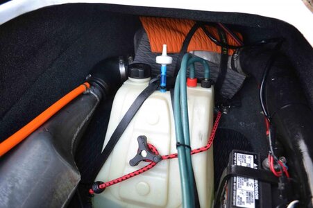

Only issue I had was when I pulled the lanyard while ridding, ski would still run?
So fixed that all up, some contacts in the Start/Stop were messed. But pretty scary when I noticed it would keep running :O
But love this ski so much! Its amazing, and hits so hard its not even funny
