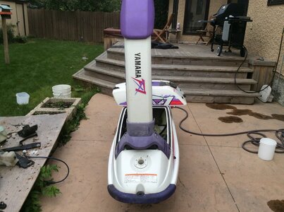

New to stand ups and need help building a ski!

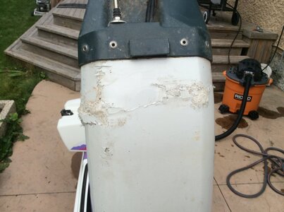

So I got a 1994 fx1 hull from my neighbor and it was full of leaves and crap. basically stuff living in there. Anyway I need help putting in a motor, installing a bilge and fixing some cracks.

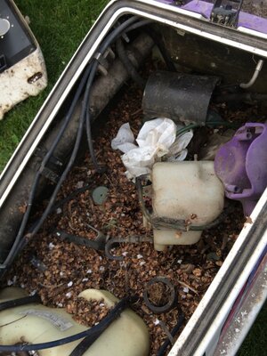

Here is a pic of the inside before I cleaned it!

Hah. That looks terrible. Definitely potential though. Fx riders are my favorite to watch at freerides. Is this your first boat.
Guam
Go pick up some quality epoxy resin and glass cloth to make your crack repairs. There are tons of threads on the glass work to get you started.
If you can wrench then try to find a complete motor with electrical to drop in there. If not there are reputable and knowledgeable builders to buy complete setups from like @JetManiac

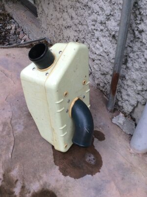

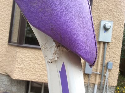

With enough glasswork that pole would be fine. Depends on the budget you're on. That's a picture of the waterbox. It's basically a baffled muffler

Fx1 poles are similar to rn poles and they are not weak.
X2 I had one on my carbon freak for the length of ownership. Its full of foam and will help right the boat in the surf.
also go with trinity composites for a quality resin, and biax glass will do like vumad said, but I always get some s glass to help soak up the excess from the biax then sand smooth.
