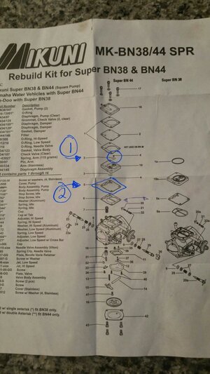

--in the mikuni carb rebuild kit.the (Blue Number two) gasket was not in the carb when I opened it up but i put it in becuase of the picture.. was that right or wrong? Also may have flipped one of the clear discs (check valve-Blue number 1) cant remember.... This may be the cause of the tunning issue.. see below.

Screws were set at 1.5 turns out to start... felt very underpowered and not crisp slight lag snapping to WOT. turned the pilot out and tested various turns out... all the way out to 3.5. At this point it was slightly better if anything. Plug was lean looking (grey). Did not go WOT for any period of time all through the ride. Tried to dial in the pilot but unsure where to go from here... up the pilot and richen and work back? Pull the carb gasket out? Recheck disk?
Thoughts?
