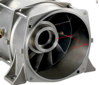

Hopefully somebody here can help me out. I am trying to figure out what driveshaft I need to put a stock 155 pump in my Maxx hull.
I have received a measurement from a Maxx setback pump from the face of the wear ring to the end of the splines (see picture below, not of the same pump but what was measured).
I need to know what the distance is from the face of the wear ring back down to the face of the stator hub.

If the MAXX hull, uses normal 96-07 shaft for lets say 144 OEM pump.
You would need to get a shaft, that is +15mm longer than the stock OEM 96-07 shaft.
The 155 OEM stator sits 15mm "setback" compared to a OEM 144mm pump.

I've had this situation / setups a few years ago. OEM 155 pump in a KDX hull
You can run stock OEM 96-07 shaft, but your spline engagement will only be 25mm of the 40mm - hence why the shaft needs to be +15mm longer :)
