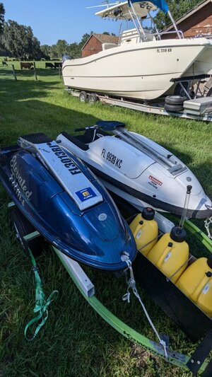

I just picked up a couple of '95 750sxi's and, while I am definitely out of practice, I was able to get on my feet on the first try and handle some basic turns & wakes without getting thrown off. The problem that I'm running into is that any time I try anything more than that, the pump cavitates/comes out of the water and I'll lose all momentum.
For example: Takeoff from a dead stop - Squeeze throttle, pump cavitates, feather throttle, pull myself onto ski, pump cavitates, feather throttle, stand up, pump cavitates, etc... It kinda feels like the hull is too short for my 6'0" 225 and I keep leveraging the bow up, uncovering the intake.

- Both skis have aftermarket poles, Jet Dynamics intakes, one has an Ocean Pro ride plate, the other has a Jet Dynamics ride plate as well as a few engine upgrades. (Single carb, Factory pipe)

I don't think there is anything mechanically wrong with the skis. Everything looks good and the 120lb boys riding them didn't have the same problem.

Apparently I already have a shortened pole on one of the skis. The pole on the blue ski is about 37" long (pivot to pivot) and the white ski is about 40". I could easily shorten the tubular pole on the white ski though. I have a TIG & know how to use it. LOL

A rider of your size/weight should be able to ride a 750, with some skill. The white ski appears to have a longer than stock pole which will definitely NOT help.
